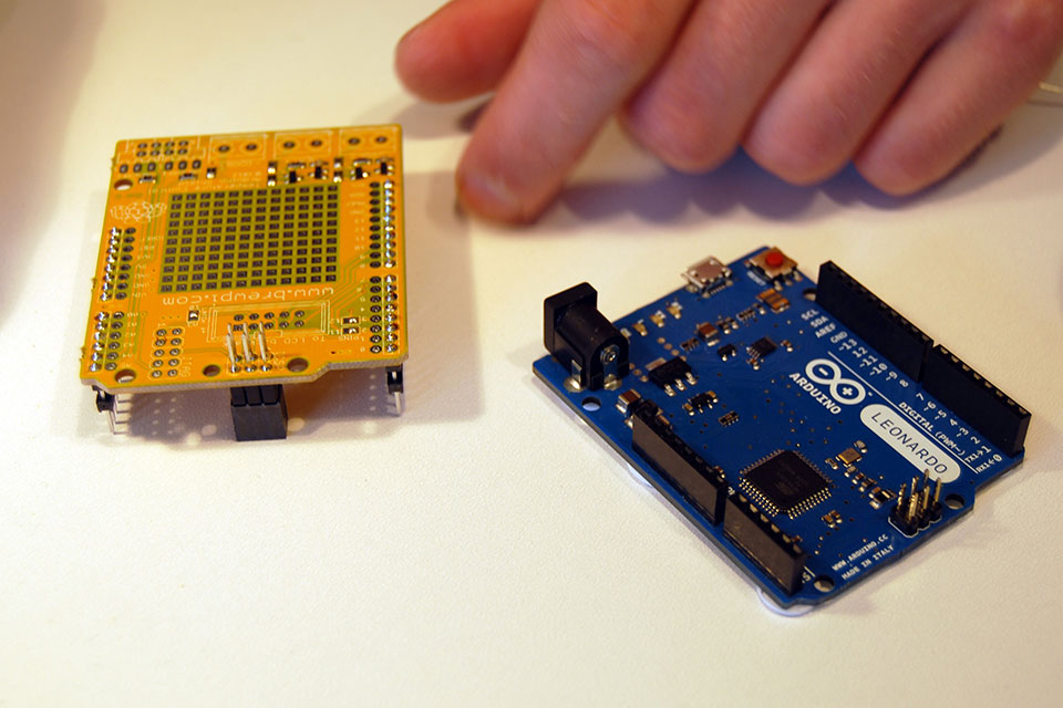

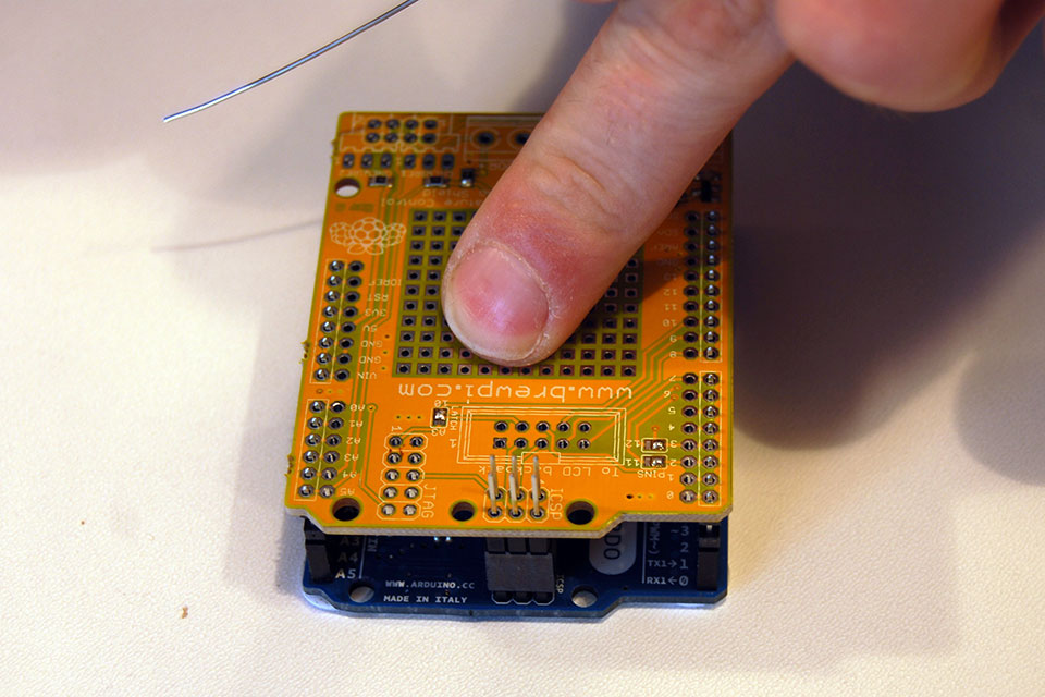

We will start by soldering the Arduino headers. Insert them into your Arduino to hold them straight.
Put your shield on the headers and press down firmly.

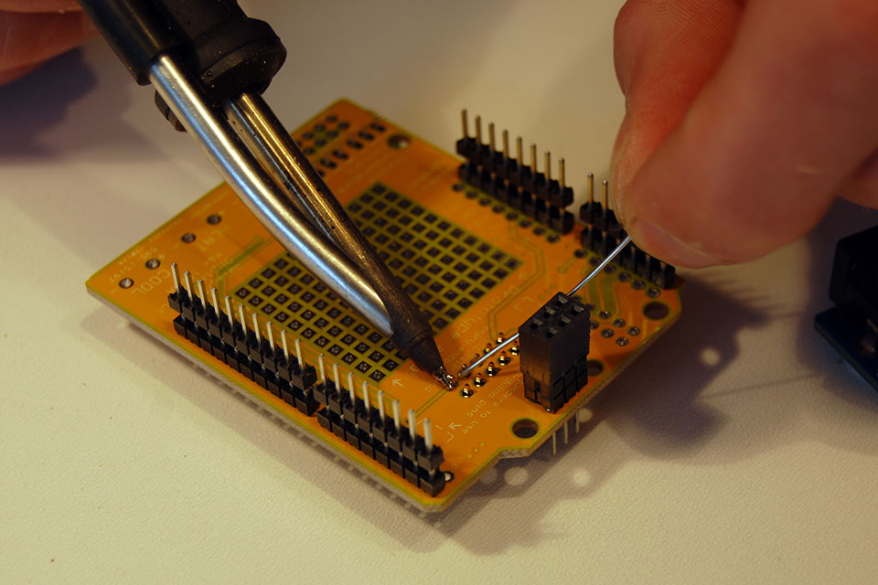

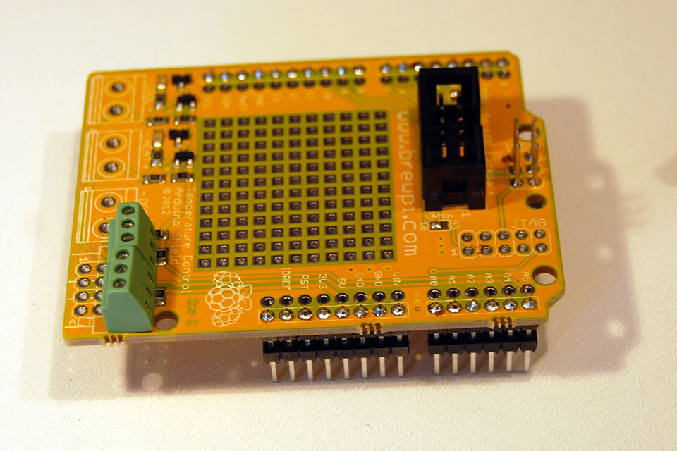

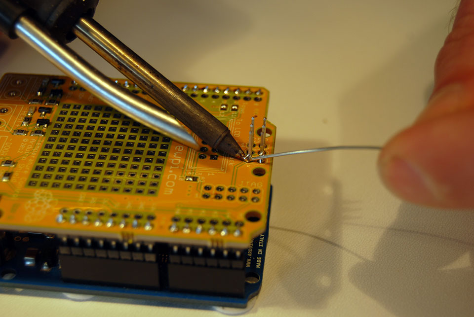

Solder the 4 Arduino headers to the headers to the board.
On the ISP header, try to solder only the bottom bit and keep the pins clean.
When you are done you can take your shield off your Arduino

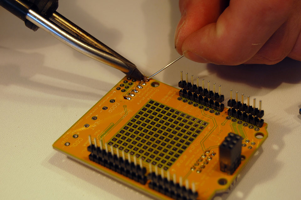

Next are the mini screw terminals for the temperature sensors and the 10 pin shrouded IDC header. We will do both at once because they are the same height. Insert them and flip your board over. Take note of the marking on the board for the orientation of the IDC header. The open bit points towards the 6-pin ISP header.
Solder the small screw terminals.
Solder the shrouded header.

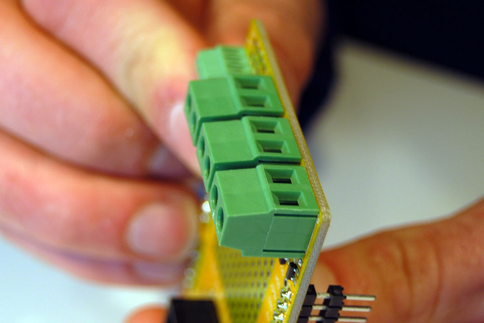

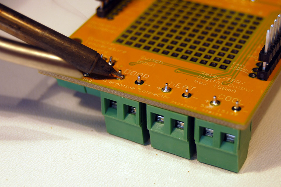

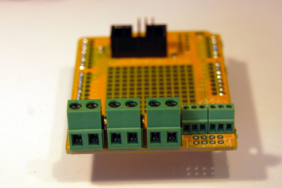

Last parts on the shield are the bigger screw terminals for heat, cool and door connections.
First solder one pin of each connector. Pick the one that is not connected to the ground plane.
With one pin soldered, check the alignment and make adjustments where necessary.
Solder the other 3 pins. Because they are connected to the ground plane, they will take a bit longer to flow.

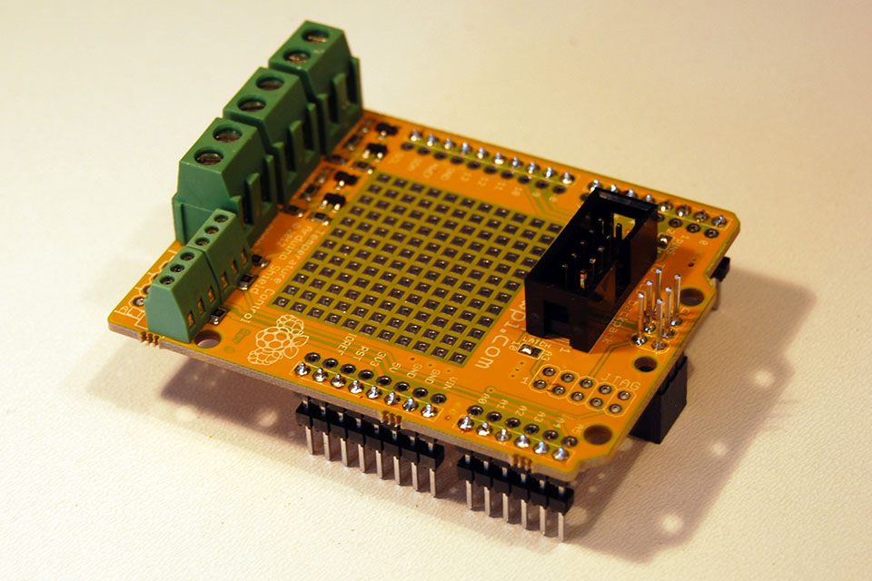

Main board is all done! Next is the LCD backpack.
