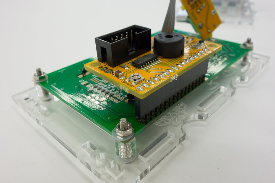

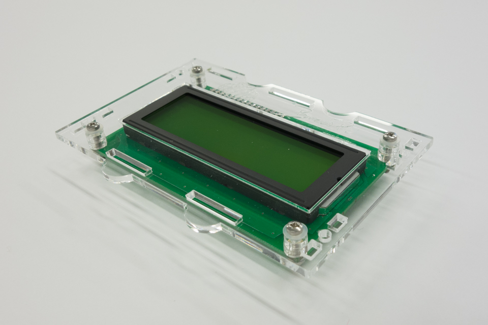

Step 3: mount the LCD display to the front panel
These are the parts you will need to mount the LCD:
  • 4x M2.5 bolts and nuts
  • 8x M2.5 washers
  • 8x laser cut spacers
  • The front panel
breaking off laser cut spacers
We laser cut 11 spacers (1 spare) to create some distance between the LCD board and the front panel. The laser cut spacers are attached to a bar, break them off to use them.
Assembling LCD and front panel
Your sandwich should look like this, from bottom to top: bolt, washer, panel, spacer, spacer, LCD, washer, nut.
Front panel and LCD assembled
If you’ve done it correctly, the display should line up nicely with the panel.

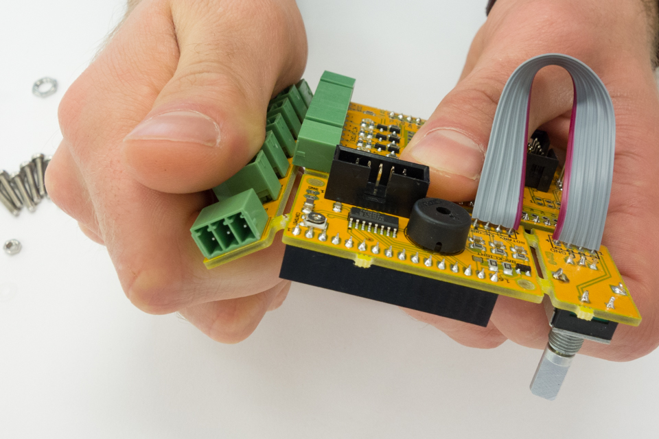

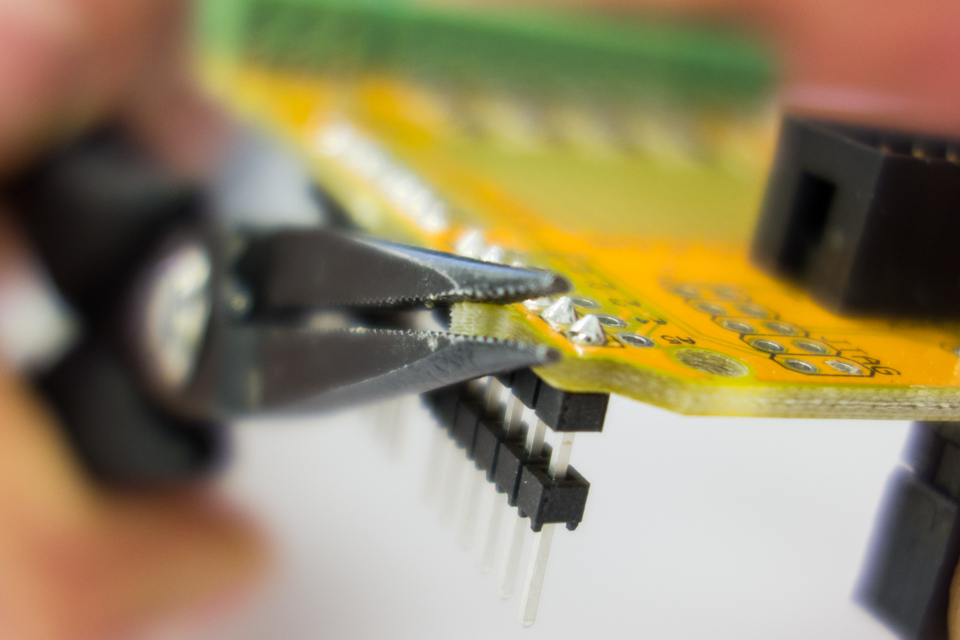

breaking shield into separate boards
Break the shield into separate boards.
breaking off the mouse bites with pliers
The boards were held together by small tabs called mouse bites. Break them off using some pliers.

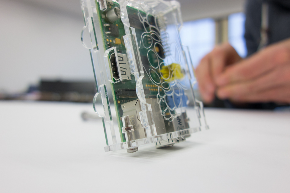

Put the Raspberry Pi on its head to start inserting the bolts
Insert the bolts, with a washer between the case and the bolt head.
Insert the bolts, with a washer between the case and the bolt head. The nut will pull the long panels into the  shorter panels. Do not overtighten, this might crack the panel.
Repeat the process on the other side and you're done!
Repeat the process on the other side and you’re done!

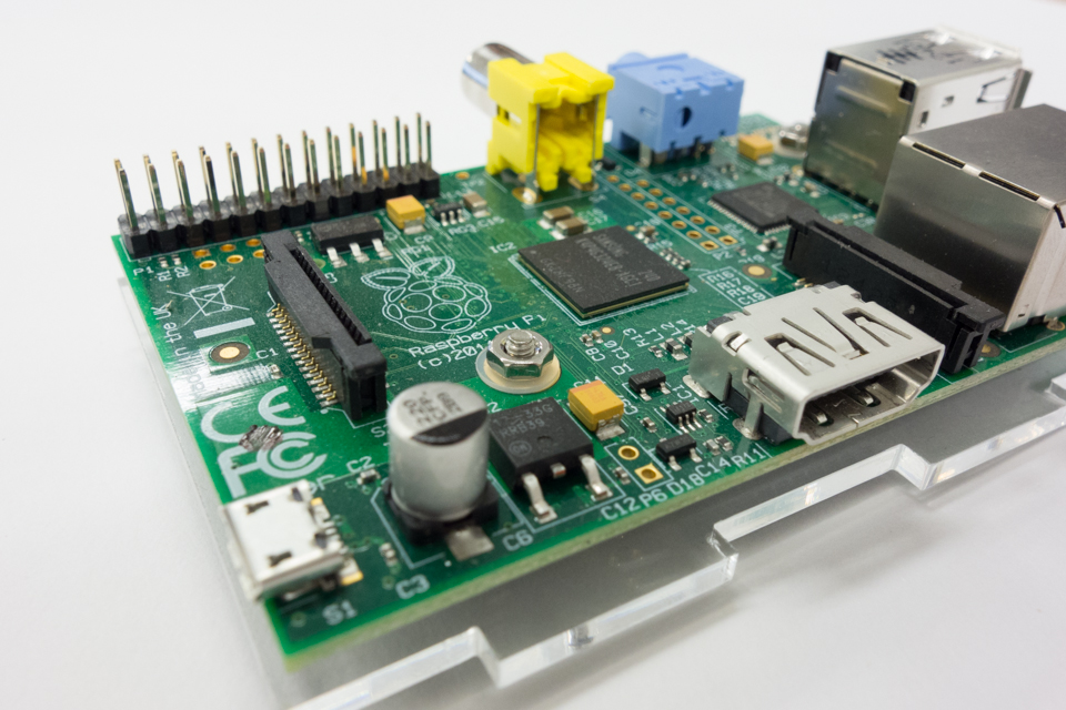

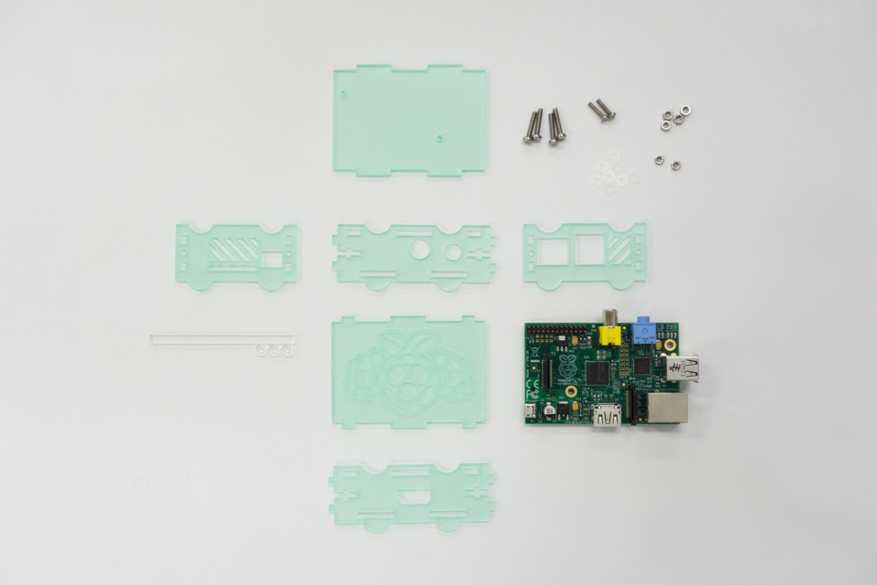

The Raspberry Pi case (model B)
This will explain how to assemble the Raspberery Pi case for the Raspberry Pi model B (with 2 USB ports).
For this step you will need:
  • A Raspberry Pi model B
  • The six Raspberry Pi case panels
  • A bag of nuts and bolts, which should contain these parts:
    Amount    Part Type Used for
    4 M3 nut DIN 934 Box panels
    4 M3x16mm bolt DIN 7985 Box panels
    4 M3 plastic washer DIN 125 All M3 bolts
    2 Laser cut spacer   Under Raspberry Pi
    2 M2.5 nut DIN 934 Raspberry Pi
    2 M2.5x12mm bolt DIN 7985 Raspberry Pi
    4 M2.5 plastic washer DIN 125 All M2.5 bolts (2 per bolt)
Parts to assemble the Raspberry Pi case
Parts to assemble the Raspberry Pi case.
Raspberry Pi standoffs
Start by fastening the Pi to the bottom plate, with the following sandwich: M2.5x12mm bolt, washer, bottom panel, laser-cut spacer, raspberry pi, washer, nut. The easiest way to do it is to lay the panel flat onto the table.
Rpi mounted
The Pi is fastened to the bottom board.

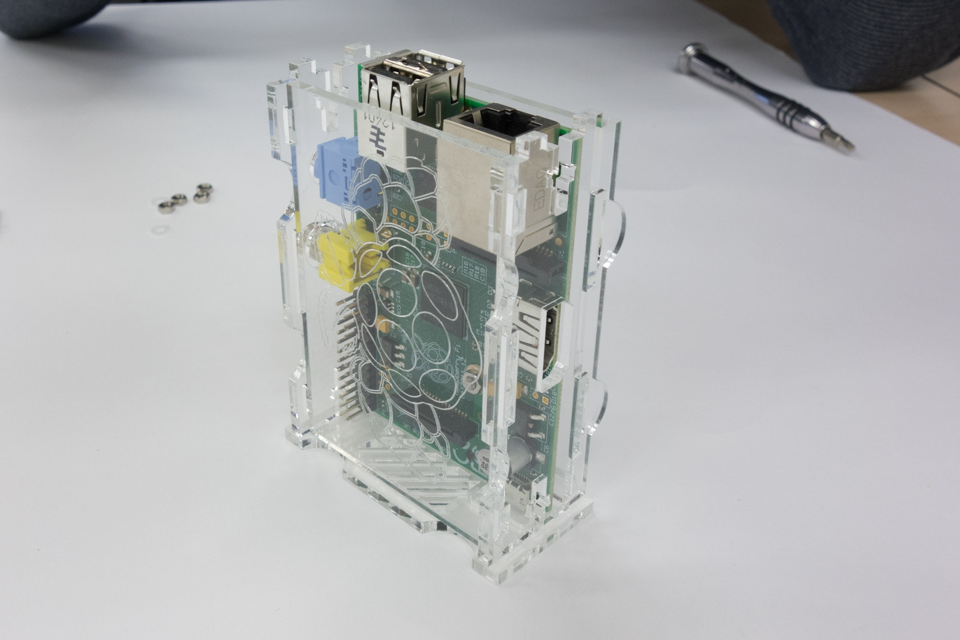

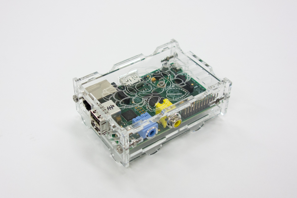

We’ll use the same tactic as with the Arduino case: Put the panel with the micro USB power connector flat on the table. Attach the side panels to the bottom panel and insert them into the panel on the table.
Raspberry Pi case standing on its side
With all sides assembled, the construction is stable enough to stand, even without screws.

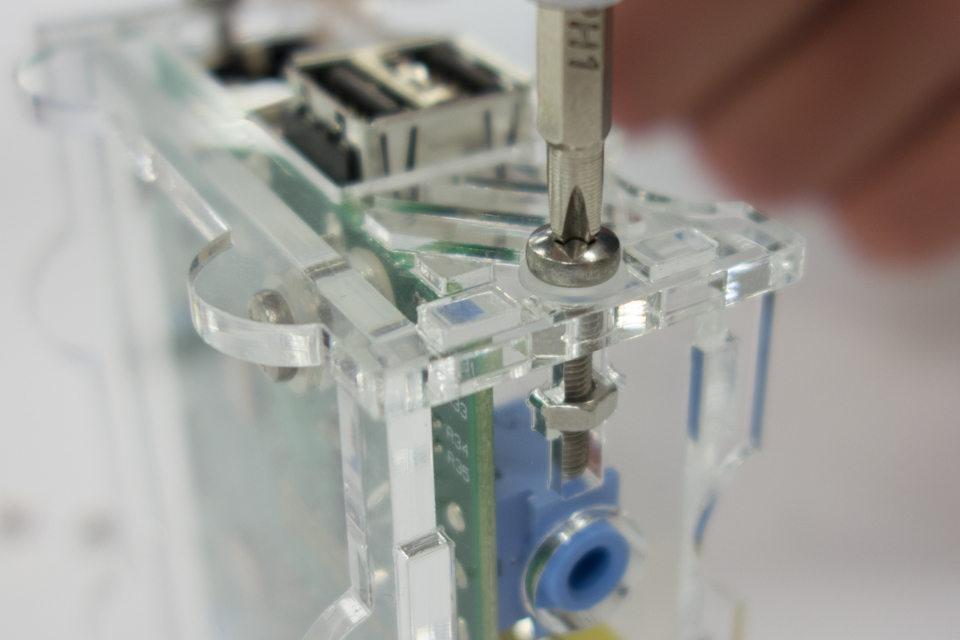

fasten the final panel
Add the final panel and fasten it with 2 M3 bolts, washers and nuts.
Raspberry Pi case final step
Now flip it over and do the other side.
Raspberry Pi case done
Done!
